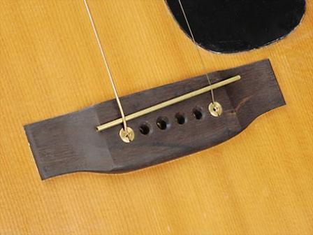

You will probably get just a little bit of orange peal. You would still have to rub-out in the areas around the bridge and fretboard if you sprayed these areas, to get it to blend wth the rest of the French polish. It is tuff not to get it on the bridge and FB and the alcohol can wick adhisive from masking tape if you mask them. It is still going to be difficult to get it to look as clean as it does when finished without the bridge and fretboard.

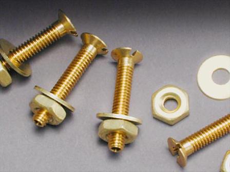

If we are talking steel String guitar here you can use the threaded tubes and nuts that Stewmac and Lmi sell to temp mount your bridge for testing, then take it off and finish it
